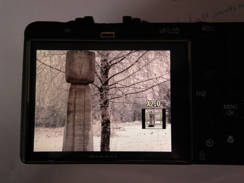

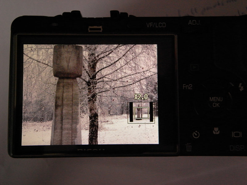

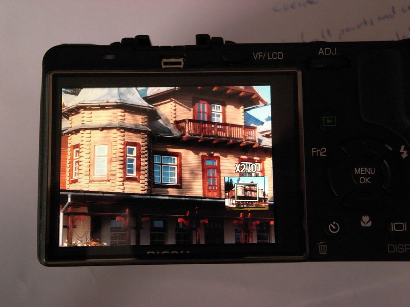

There are also some screen artifacts. Below pictures displays GX200 LCD, but it's the same on GRDII LCD.
