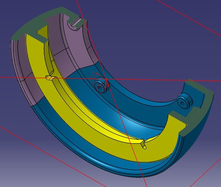

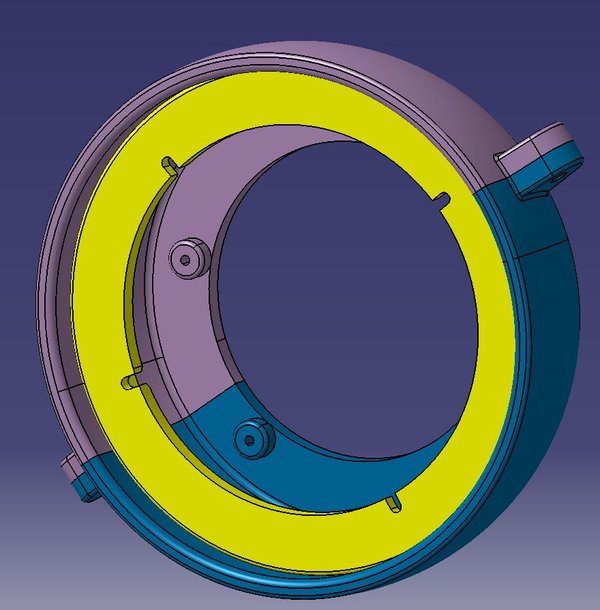

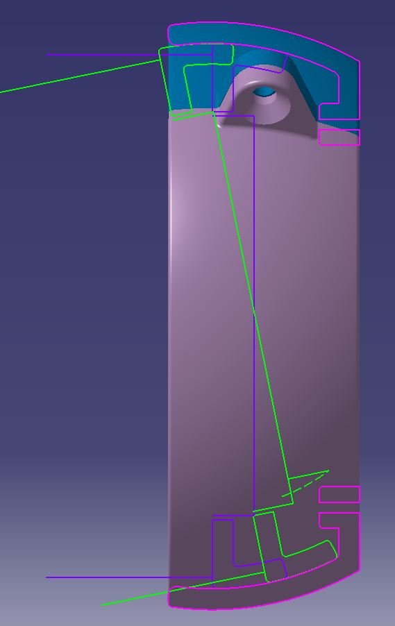

I've been toying with the idea of making a Tilt Adapter to suit mounting a Pentax/Ricoh Manual SLR lens on to a Leica M Mount flange.
Here's what I've got so far.
It would involve removing the Pentax/Ricoh lens mount flange screws from your chosen lens and attaching the inner part (shown in yellow) with slightly longer screws (leaving the lens mount flange in place). Then screwing the other two outer halves together and attaching a Leica M Mount lens flange at the rear.
The design will retain proper infinity focus in the "dead ahead" position.
Just waiting for my company's 3D printer to come back on line and I should be able to make one up.
If anyone else out there has access to a 3D printer and would like to have a go at making one just let me know as I would be happy to share the files I've made.
Cheers.
Rohan.

Clever one Rohan,
I am presuming that this is incorporated in a PK to LM adapter mount? I am a little confused.

Hi Tom.
As you suspected, my design is basically just a PK to LM mount adapter with a tilt mechanism incorporated into it. Unfortunately there's not quite enough space to easily include a quick change mechanism as the normal adapters do. This could be done but the adapter size would need to be increased in diameter. This is something I might look at doing if I can prove the concept works with this simpler version.
