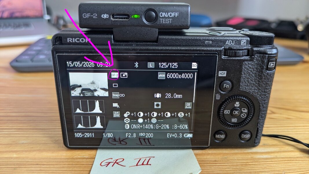

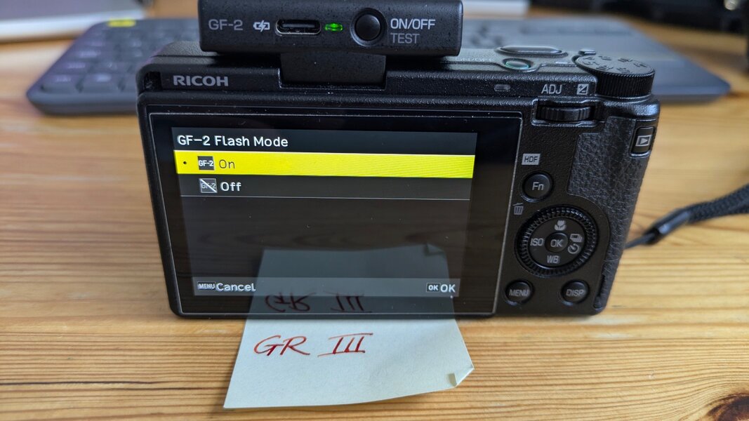

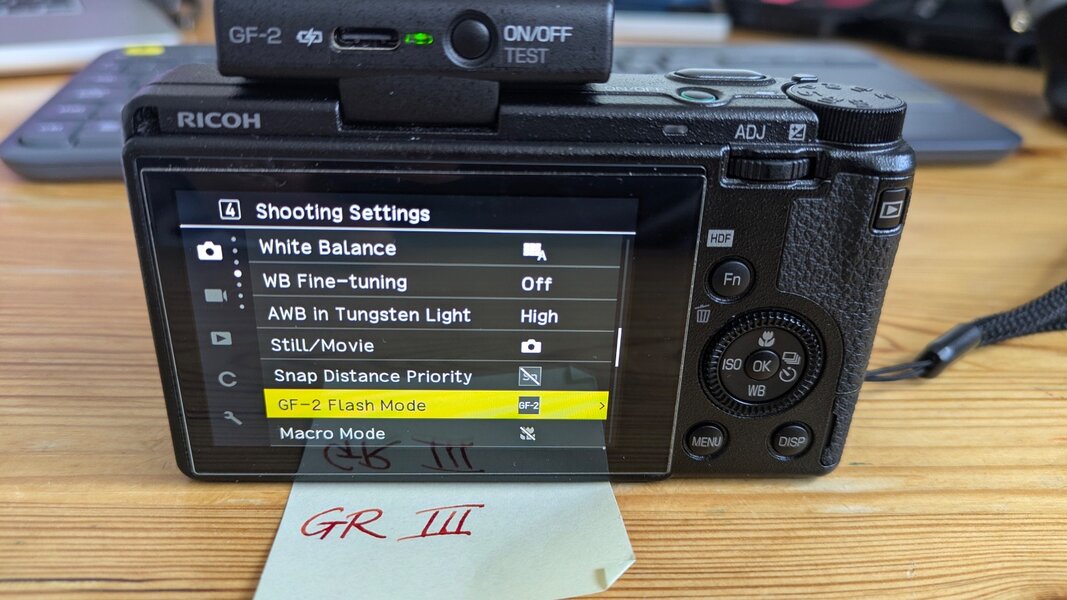

I also have a GR III HDF... here is my analysis.
on my GR III HDF:- FW version 2.10
I activated the 'GF-2 Flash mode' setting.
The flash works very well with the GR III HDF.
See attached photos
