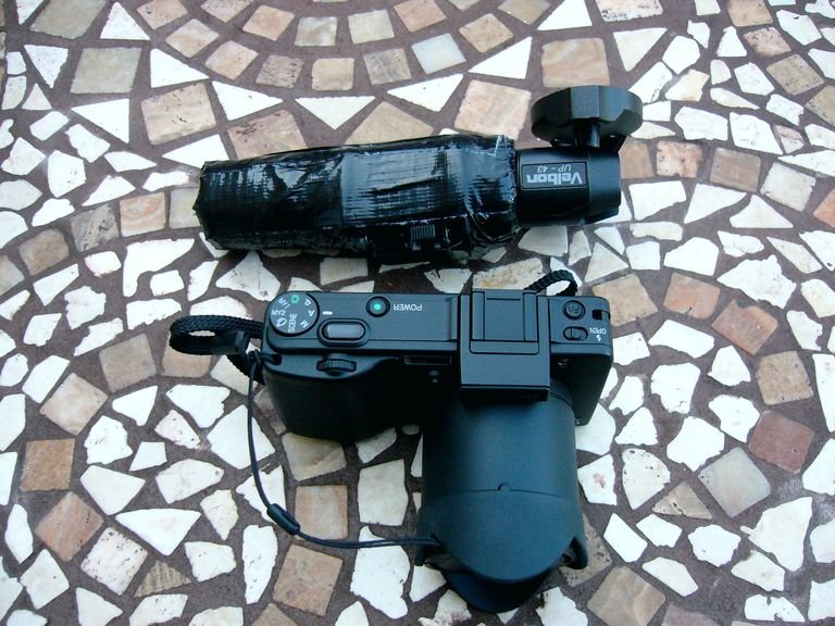

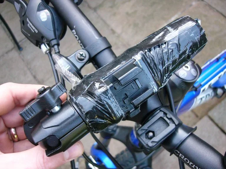

Ok...i made 1!!!!!
I used a old monopod that i bought about 6 years ago...and never used!, a hacksaw, some electrical tape,a file, a light from my bike which was broken and some Super Glue.
I removed the battery cover from the light and hacksawed off the front and the back from the light so only the battery compertment with the bracket for the handle bar remains, next i cut the battery cover the same size, then i filed down all of the edges so they where smooth. i was left with only a hollow tube(the battrey cover and the remainder of the light) which would fit onto the handle bar fitting.
Next i rolled back the foam handle at the top of the monopod and cut off the leg from the monopod so i only had the half of the "handle" left....i filed down the sharp edges and rolled the foam back and tucked it into the hole at the end.
I made sure the monopod would fit tight and snug into the shell of the light (the foam handle helped to keep it secure) i needed to file away some of the interior of the battery housing.
Next i glued the battery cover in place with the monopod inside. When the glue was dry I tapped up the cover very tightly at both ends, then i wrapped up the rest of the housing, after that i wrapped up the rest of the assembly so it is tight and very secure.....
it was really simple to make and took about 1 hour once i had everything at hand......next job....get out and use it
