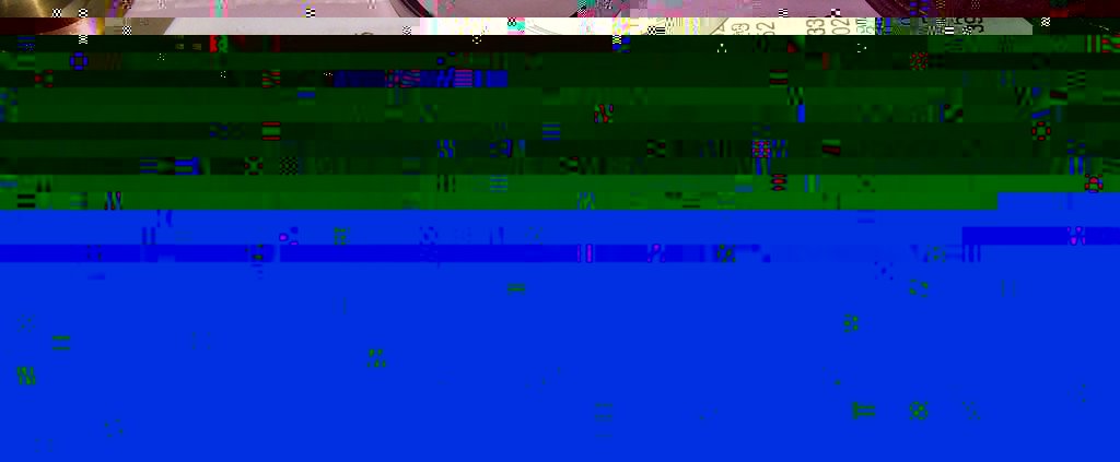

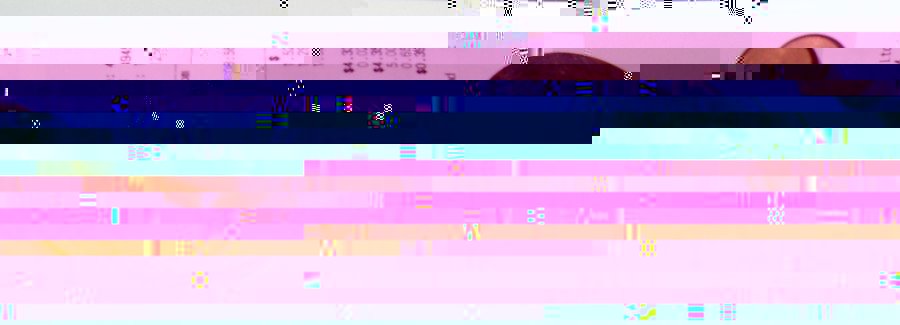

I purchased a Ø 37mm UV filter online from Ebay because Ø37mm isn't easy to find here in Australia. It was also cheap inexpensive.
So it got me thinking, is it any good at that price? I've never heard of that brand before. How can I test it?
This is what I came up with.
One shopping receipt from local supermarket. Two paper weights to hold it down. A UV filter to test. Full sunshine with UV, from the Bureau of Meteorology (UV Alert: 9:20 am to 5:20 pm, UV Index predicted to reach 10 [Very High])That should do it. 3 hours in the sun.With the paper weight removed & no sun light, it is my control.
I think at the end of my test (And it's not that scientific) The UV filter did stop some of the UV radiation. But I baked it in direct sunlight for 3 hours at 48°C (118.94°F). I prity sure it will do the job.

Interesting that your top weight did not do as good a job at blocking everything as the big round one did.

Interesting and useful test Phil! But in my opinion, there seems to be very little (if any) difference between the UV "protected" and unprotected area? Is the UV filter made by any known brand? Unfortunately, ebay is full of very cheap and often useless imitations ;) And maybe it's just a bad luck with different UV frequency as suggested Bill?
