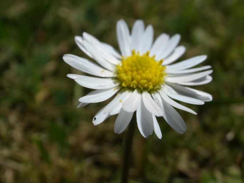

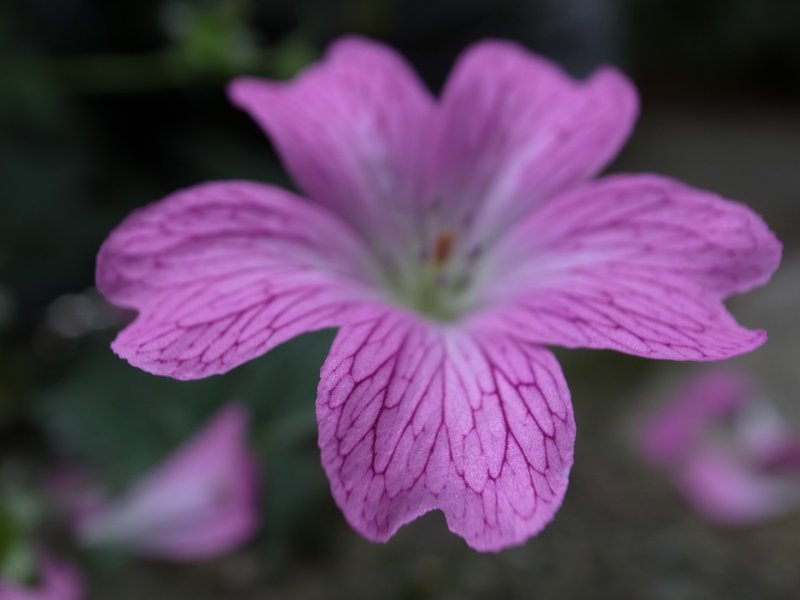

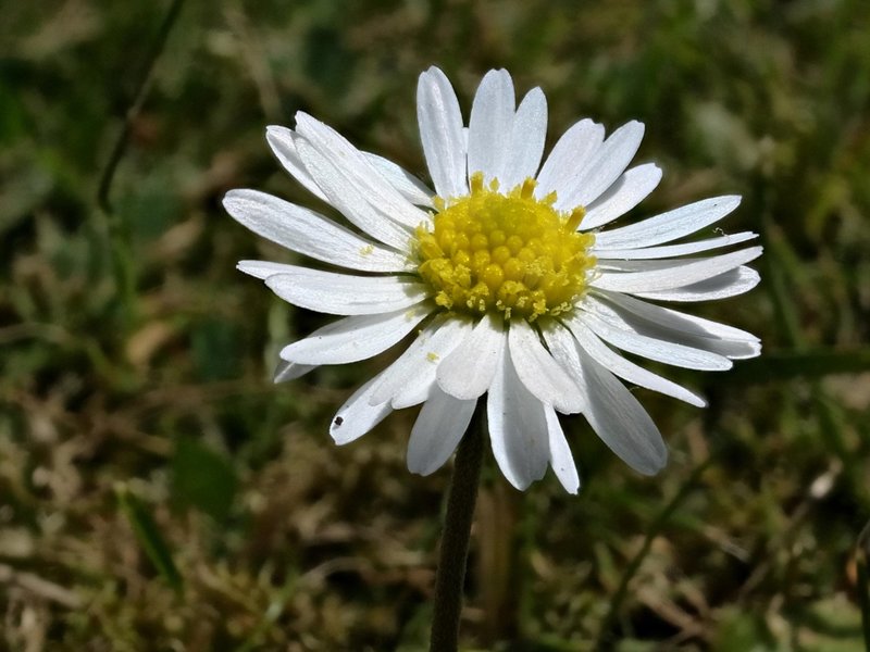

With any luck you should get something a little like these
from taking lots of pictures that look like this
looeee
