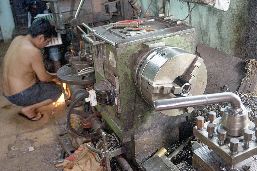

so I took the case into my own hands and found a workshop that has a turning lathe

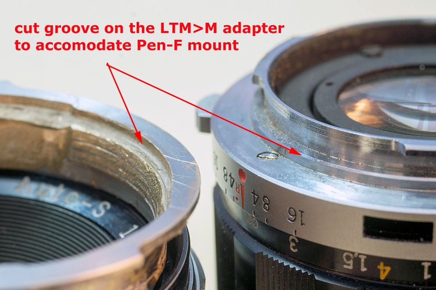

for first thing to be able to accommodate the Pen-F lens mount seen to the right is to cut a groove inside the LTM>M adapter seen to the left:
I told him to cut it as deep as it protrudes on the lens mount and that almost cut the adapter into two pieces! Only half was still connected, half of the inner corner of the groove cut all the way through. Do I make myself understood?

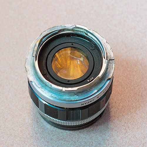

Later, when reducing more from the inside of the adapter to make room for the Pen-F lens mount it actually completely broke into two pieces. I simply superglued the two parts together again and proceeded to file out what was needed from the LTM>M adapter to accommodate the Pen-F lens mount which was not easy, the adapter becomes very thin. It looks terrible but in the end I was able to mount the lens on the adapter though I would not have found any way to cut it further to be able to lock the lens in it.
Looking for an alternative I thought that it might be easier to swap the mount on the lens to be LTM, but screwing off the mount from the lens reveals that it exposes a lot from the rear of the lens, so that won't be easy neither:
However the register distance of the Pen-F mount is 0.15 mm longer than that of LTM. Therefore cutting the groove seen on the first pic with precision 0.15mm less deep may be just enough to keep the adapter in one piece. Most likely not enough for anyone to make a commercial product but possibly enough for a DIY adapter. Furthermore modifying the adapter to make the lens lock is beyond me and therefore I gave up on the adapter project.
Instead I plan for a non destructive, easily reversible conversion of the lens to M mount: For that I'd cut another LTM > M adapter similar again but with the groove 0.15 mm less deep and I'd try to cut out the space for the Pen-F bayonet more precisely using a milling cutter instead of only using a file. In the end I would simply screw this modified LTM > M adapter together with a 0.15mm spacer or metal ring, on top of the lens mount using longer screws, utilizing the original screw holes on the lens.

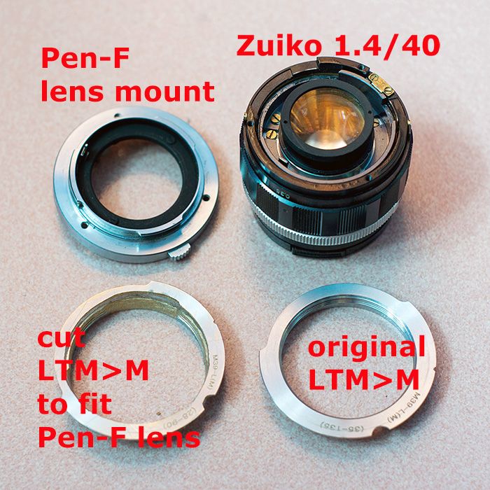

Even though I still think that it 'may' be possible to cut out an LTM>M adapter to make the Pen-F mount fit into it, so that the adapter can be screwed on top of it, this would need various very precise tools and quite some cutting. The piece still might come out too fragile to be really useful.
So in the end I opted for a different route, decided to change the mount.
Taking off the original mount will leave the last half cm of the sides of the lens exposed
therefore I had a piece of brass cut that covers the rear of the lens just like the original mount
and screwed a M39>M adapter on top. It needed drilling 3 wholes for the screws, ( which was done very badly by the workshop that had cut the cover and later very well by my 'lens doctor', thus 3 'wrong' wholes ) three slightly longer screws, and well, a rubber band to make the aperture work ;)
voila:
Pen-F Zuiko 1.8/38 mounted on the GXR M
there is no harm done to the lens at all, restoring original condition just needs opening 3 screws, putting back on the original mount and tightening it's 3 screws, it is very easy.

I'd first cut off the protruding 'ring' on the mount, here pointed at with the arrow, that would save having to cut a groove on the adapter
and reduce the locking parts of the bayonet until the whole mount of the lens fits inside a LTM>M adapter and then screw the adapter on top of the reduced mount. Register distance would end up just about right, register distance of Pen-F is 1mm longer than that of Leica M and the LTM>M adapter has thickness of 0.85mm, that is one still could add a shim of max. 0.15mm to get it exactly right.
However one would still need to drill three wholes in the LTM>M adapter, just as I did for my conversion. To do this precisely is not all that difficult, my adapted lenses are perfectly well centered.
This method would save having any part machined but as you point out it also would be destructive. Advantage would be that the original f stop marking still would be there, my adapted lenses don't have any, but actually I am not missing them and don't plan to add markings on my machined part.
