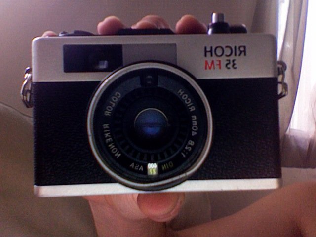

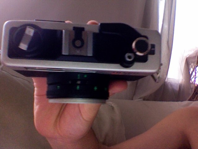

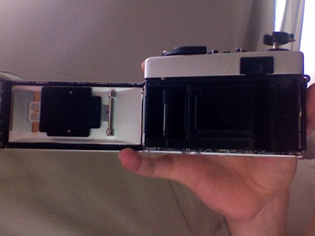

here are some quick pictures:

Lens rim is bent for a reason, I assume your Ricoh has got a good knock...which in turn could impact aperture mechanism. Standing in your shoes I wouldn't even think spending 50-100 euros for repair. If you can, return it. Otherwise either use it in manual mode (somehow missed if manual mode work OK) or get another fixed lens rangefinder, if you want AE. Expect almost any of this 40 y.o. cameras will need some work because they gum up after decades without use but rule of thumb is to avoid cameras with signs of mechanical impact as most of times it's isn't only cosmetical issue.
I had Ricoh 500G and it had metered manual mode, something not very common on cheap fixed lens rangefinders, I'm not sure about your model but it could. Potentially this series has strong sides but all others FL RF's also have their selling points.
