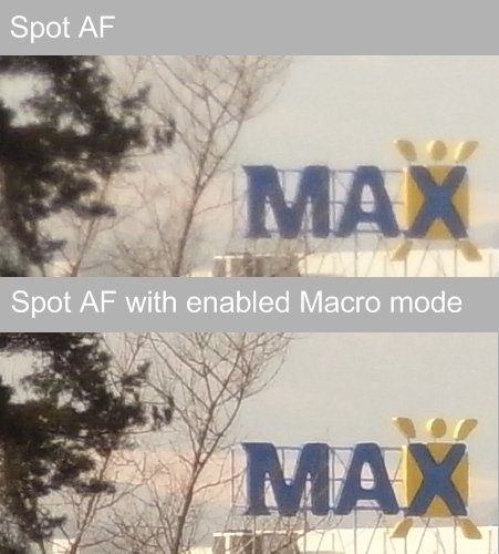

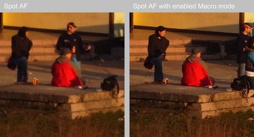

I'm sure, many of you noticed an overall image softness at tele end. Aside the slightly soft starting aperture (f4.4), the problem seems to be caused by GX200 AF. It's not consistently reproducible, but there is a consistent cure for this problem ;) All you need to do is to use the Macro mode. Unfortunately, this will make the already slow GX200 AF even slower. But it definitely helps.
Here are some samples...
