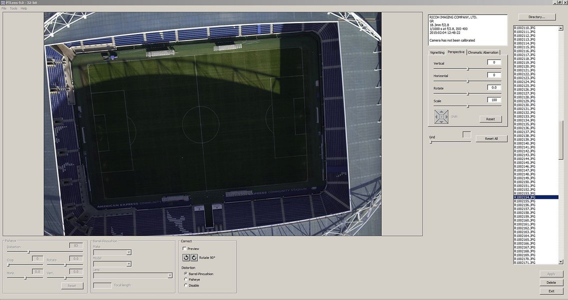

In the top right hand box (this football stadium is the pic I want to test for corrections, BTW).
Rgds,
Rob

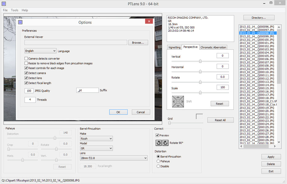

Hmm. Here's what I see.
I've included the options window. Is your set-up similar?
Looks like a support message to Tom is needed.
Sorry I can't help further.
Roger

This is helpful, thanks Roger. Yours is the 64-bit version. Mine is 32. Wonder if that is making the difference?
I'll ping Tom.
Rgds,
Rob
