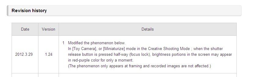

Seems like Ricoh is aware of this issue as they have just solved a similar problem for Ricoh CX6 in new firmware. See quote below.
Should we get it soon in 1.51? ;)
