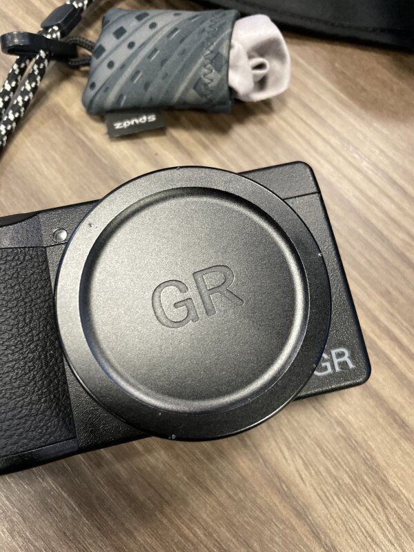

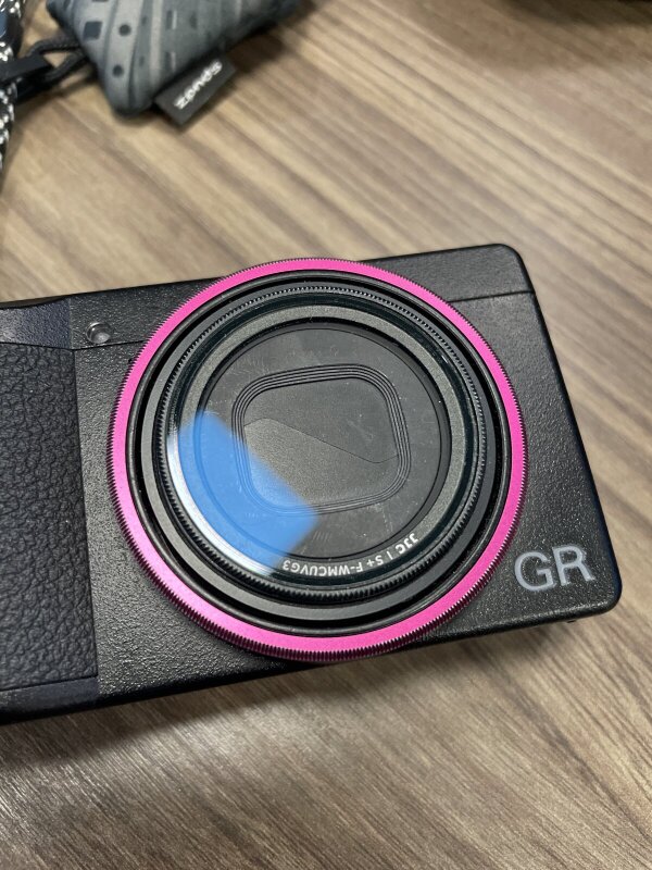

Dust is an apparently issue there is a simple answer. I bought a stick on UV filter (JJC) and a metal lens cap on Amazon, sorted.
Photos below

Sorry to learn of your troubles. Any chance your camera is still under warranty? If you check with other repair services, you may find a less costly shop. I have had my GR IIIx a couple of years and keep a JJC lens cap (pictured above) on mine except when shooting. I also wipe off the extended lens barrel with a microcloth and blow off the lens from time to time. No filter for me tho. So far no dust.
