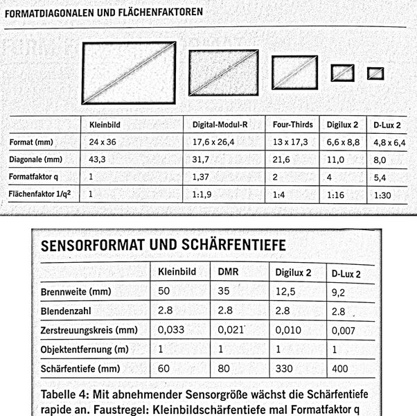

Christian, this phrase is not precise. Should say LENSOR and not SENSOR. Tabelle 4 includes both, the brennweite (focal length) and zerstreuungskreis (circle of confusion), so it is an evaluation of how the DOF increases when we go from a complete 50mm/FF to a 9.2mm/Compact system (which varies focal length and CoC) that is what I call "final effect in a compact system" because the focal length DOF increase is stronger than CoC decrease effect of the DOF.olyz":1vo2uw80 said:Hi rondo, the translation of Tabelle 4 "Mit abnehmender Sensorgröße..." is:
With decreasing sensor size the DOF (Schärfentiefe) is increasing rapidly.

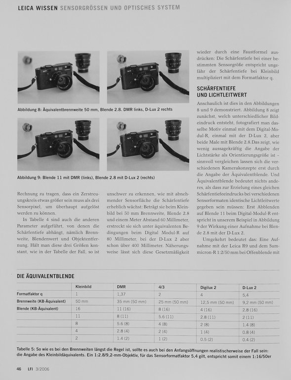

Again your phrase is not really complete and could induce to some misunderstanding, it should say:olyz":2o10cvoj said:... and 2 photos with different sensor at f 2,8 / distance 1 meter...
