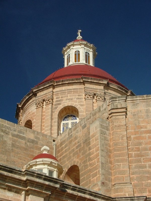

Here is one taken with a polarising filter on my Fuji s5000. Apart from a touch of sharpening this is how it came out of the camera. I don't think you can get the same effect with post processing.
