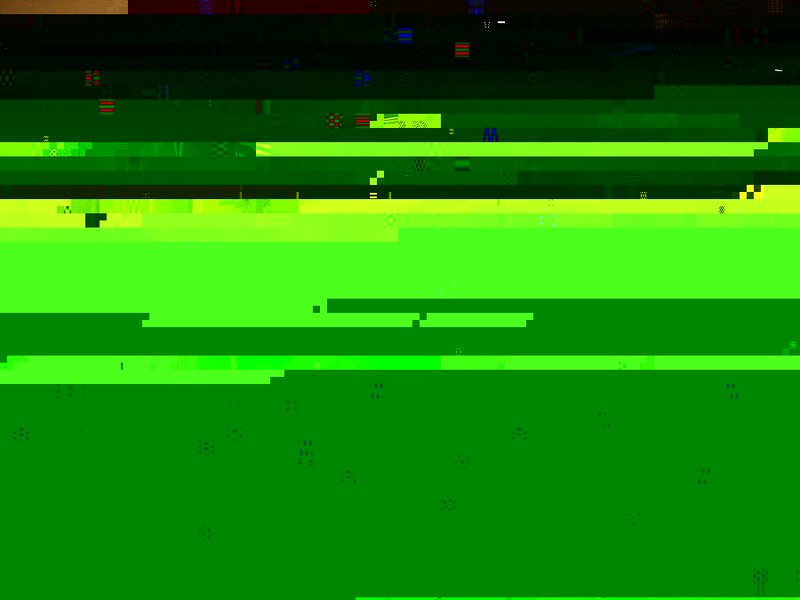

God, I've gone it again.
Reached for this camera because it was at hand.
Shot some shots with this camera & can't get the images out.
In a way it is broken. No good having a camera that takes images that doesn't let you have them.
Maybe its just the card. But how do I retrieve the images.
Windows XP doesn't even recognize the camera is connected to the PC.
So the camera is bung or it's the SD card. :?:
Well it is a kerfuffle not being able to retrieve images from any camera.
But I did by putting the SD card into another camera & connecting to the PC that way.
Thank you old school Kodak C433 for your help.
As I said before. The GX was at hand & just want a shot of the early morning sun streaming through my window.
So the camera my not be kaput. It my just be a dodge SD card.
To check however it is the sd card or usb-connection in the camera which have gone kaput. Take a random-pciture with the camera without sd-card in it so that it is stored on the internal memory in the camera and then connect it to a pc and turn on the camera, if needed, and see if it connects.
I think there is the option 'Mass storage and original'. At least there should be as I think that the slightly older Caplio RX was on of the first Ricohs to have that feature.
