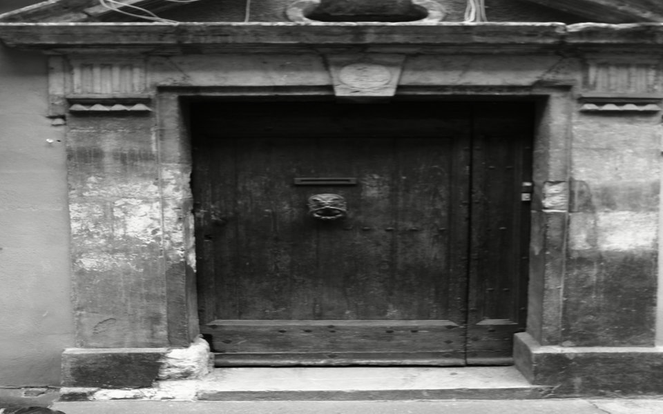

hi to all
i've here a big problem....i can't take sharp images with my grd4..all pictures are blurred. i've also done a hard-reset...nothing.
firmware is 2.30. could someone help ? is it cause of the firmware ?
many thanks

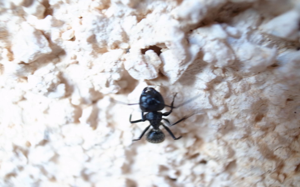

Post a couple of pictures with the EXIF and we may be able to help.
Camera: Ricoh GR DIGITAL 4
Lens: RICOH GR LENS 6 mm
(Max aperture f/1.9) (shot wide open)
Exposure: Auto exposure, Program AE, 1/16 sec, f/1.9, ISO 154, Compensation: +1.7
Flash: Off, Did not fire
Date: August 29, 2013 7:30:04PM (timezone not specified)
(1 year, 2 months, 20 days, 18 hours, 3 minutes, 47 seconds ago, assuming image timezone of US Pacific)
File: 2,736 × 3,648 JPEG (10.0 megapixels)
They certainly don't look right.
Did you have the camera set to Macro on the image of the bug?
My reason for asking is Pavel noted that the GRD will generally focus more accurately when set to Macro even if the image is not a macro.

The bug picture may be shake given the shutter speed but the door picture is less easy to understand although the image does look a bit stretched. I would ask the current owner to check the focus mode. It may be on manual by mistake.
