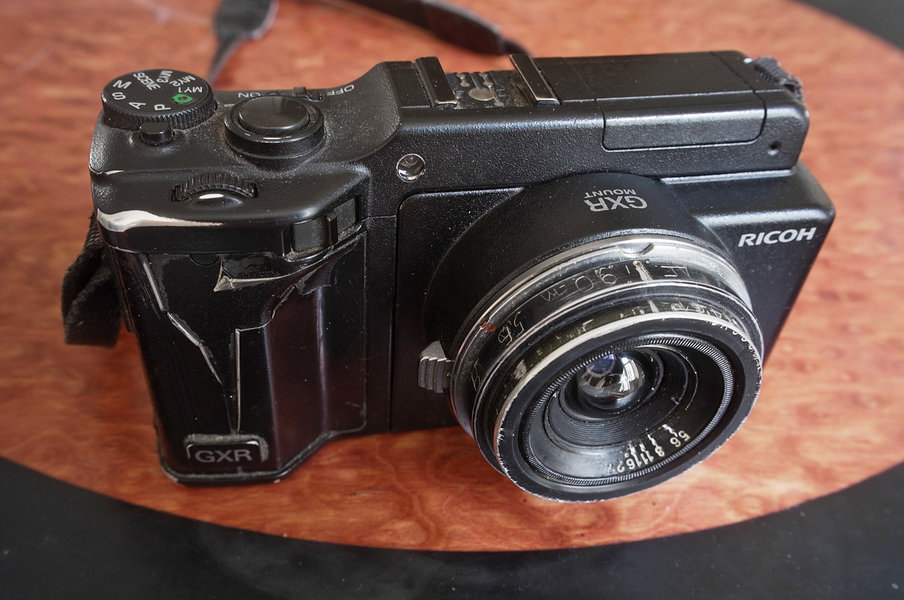

I`ve bought one ages ago and used it as a poor mans pocket wide on LTM and M cameras. It was jammed so I had to butcher it to get it going and futher on I disposed of filter ring to make it truly pocketable. Of course on FF it`s 20mm, on APS-C is 30mm. That`s why I don`t use it much on GXR. It had one merit on analogs. It`s absolutely rectilinear due to it symmetrical lay-out. Sharpness not in the class of angulons or distagons but many memorable picts were made with it in Russia with or without love. Stanis
Interesting samples. This Russar is known for it pretty consistent performance (on the contrary, as always with Russians lenses, what happened with its manufacturing). It can be seen (as much as the low res samples let us) that really the distortion is down to zero as it should, but I am astonished that with such short backfocal distance there is almost no smearing nor color cast... obviously some vignetting, but this is just physics... ;) ...Bravo for this little symmetrical...... but a bit expensive..... :cry:
